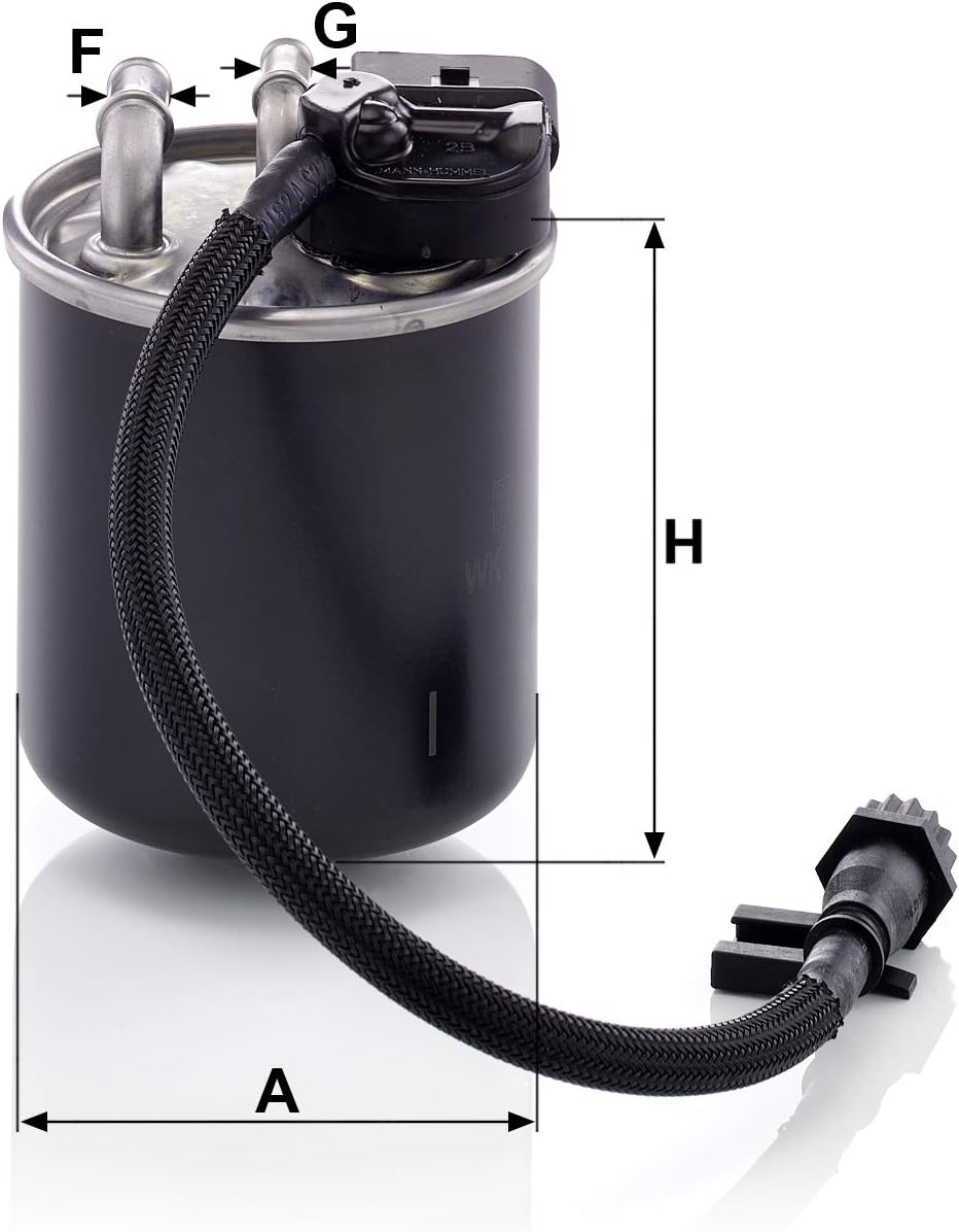

Hey guys. Wanted to post an update. My WIF light has been on constantly since my last post in 2019. I've drained the fuel several times and never saw anything bad. The fuel always looked like the photo I posted earlier. The filter, per the dealership, only has 7899-miles on it as they say they changed it and all other filters/fluids prior to my purchase. I have read some posts where the issue is actually caused by the wires that's routed to the sensor possibly being pinched due to the angle/tightness caused by the mount? Should I replace the fuel filter anyway? If so, Mann (Shown below)?
220629
... I have read some posts where the issue is actually caused by the wires that's routed to the sensor possibly being pinched due to the angle/tightness caused by the mount? Should I replace the fuel filter anyway? If so, Mann (Shown below)?

I would want to clear the WIF warning if reasonably possible. Be aware. There are some kinda fragile clips on the fuel lines. Check the filter change Write-ups for details.
When you change the filter the sensor wires could then be inspected and repaired if needed. The removed filter can be emptied as much as possible and stowed in a plastic container or double plastic bag to keep as a spare.

Hope no one put DEF into the fuel tank? Maybe bad sensor.
Looks similar to 2015 OM651 fuel filter with permanently attached water in fuel sensor, drain hose and valve.
According to Mercedes Benz, fuel filter replacement is based on time and or miles whatever occurs first. Some claim fuel filter is good for the life of the vehicle.
Then there's the consequences of biofuel, Mercedes Benz originally claimed detrimental to their vehicles but now seem to minimize its potential harm.
Best place for application to fuel filter is the dealership. Some model years, the filter was changed mid-production year.
Unless you're the original owner or, you can't go by a what is currently installed because it may be incorrect.
I would change the filter just for preventive maintenance.
If it is the same filter is in a OM651, it's a piece of cake. The biggest challenges is removing and installing the Clic R clamps.
When I replace my fuel filter I bought the clamp tool and reused the originals.
Another thing I did was place shop rags all around the area to soak up any spilled diesel and corked-off hoses until ready to re-position on the new filter.
Prior to starting, turn the key to second position for one minute and it fired right up.
